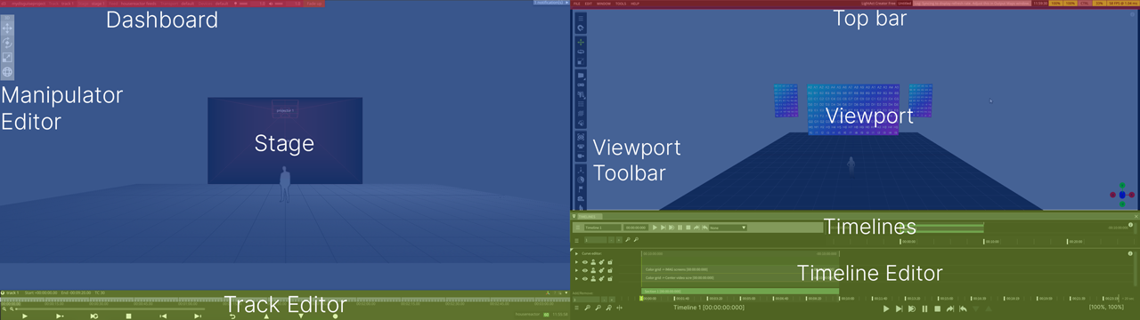

In this section, we are going to look at the differences and similarities between the graphics user interface of Disguise and LightAct software.
<figure><img src="https://3312042618-files.gitbook.io/~/files/v0/b/gitbook-x-prod.appspot.com/o/spaces%2F9sVaJpWJhPbmscipukhh%2Fuploads%2Fgit-blob-66a100e1b6848f27df4e88dfb4bd8e411b9e5c35%2FdisguiseAndLightActComparison.png?alt=media" alt=""><figcaption></figcaption></figure>
**Good to know:** unlike Disguise, LightAct uses dockable windows, that you can save into Workspaces. This allows you to modify the GUI and save it for future use.
## Dashboard
The closest thing to Disguise's Dashboard is LightAct's [Top Bar](https://docs.lightact.com/quick-start/user-interface/top-bar.md) where you can see all the Windows in LightAct software.
## Track Editor
Using the Track Editor in Disguise, you could play and edit all Tracks within a single project. Here is where you placed the desired Content Layers on the Timeline.
In LightAct, the term Track refers to a lane along which you can place layers in the [Timeline](broken://pages/gVo5IggqA2Ti6LFoq45y). Consequently, a Timeline can have lots of tracks, populated with different [Layers](broken://pages/uGObavuxs9guD7Ph8k4i), such as video, notch, image layers, or others.
**Good to know:** Unlike Disguise, layers in LightAct are not strictly defined and are completely customizable.
LightAct also fosters the term Timeline, although a Timeline in LightAct typically contains one or more Timeline tracks. You can have multiple Timelines in a single project, which you can add and manage in the [Timelines window](broken://pages/s5uC9iAZKeosFNoPuwDQ).
## Stage
All your objects in Disguise could be visualized on the Stage. Similarly, in LightAct, all Viewport Objects can be seen in the [Viewport window](https://docs.lightact.com/quick-start/user-interface/viewport-navigation.md).
