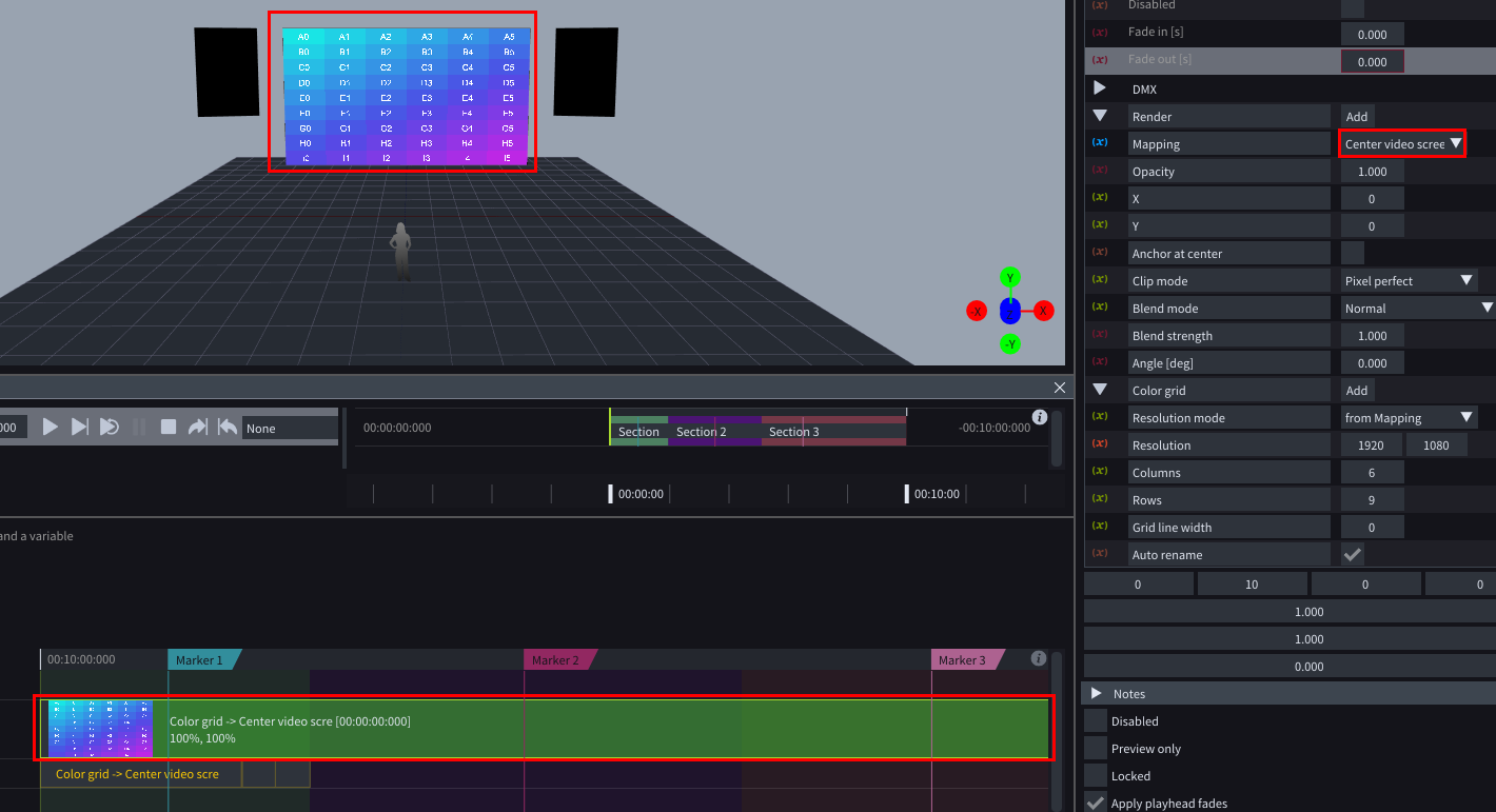

**Good to know:** Most content mappings can be achieved by simply dragging an arrow from the viewport object or a canvas to a layer.
## Direct Mapping
<figure><img src="https://3312042618-files.gitbook.io/~/files/v0/b/gitbook-x-prod.appspot.com/o/spaces%2F9sVaJpWJhPbmscipukhh%2Fuploads%2Fgit-blob-5a292e403a4352bb6eb287aa4c16269f23df91ce%2Fimage.png?alt=media" alt=""><figcaption></figcaption></figure>
What you referred to as Direct mapping in Disguise, can be done in LightAct through mapping. You can map content directly from a Layer to any Viewport object, such as a Video screen, to any Canvas or Device.

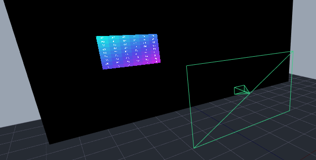

## Perspective Mapping
<figure><img src="https://3312042618-files.gitbook.io/~/files/v0/b/gitbook-x-prod.appspot.com/o/spaces%2F9sVaJpWJhPbmscipukhh%2Fuploads%2Fgit-blob-6ced2e768c7ac7b0e9802b8c7f913dc3f2428093%2F2023-08-28-10-21-38.png?alt=media" alt=""><figcaption></figcaption></figure>
Perspective mapping in LightAct is performed by mapping content from a [Perspective Thrower](broken://pages/ZaCdR6cxWAptcq2iudJJ) to another Viewport Object, such as a Video Screen.

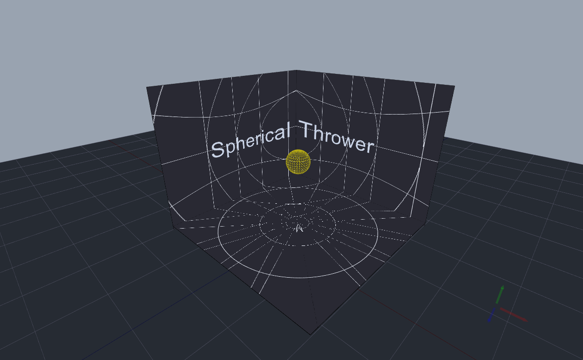

<figure><img src="https://3312042618-files.gitbook.io/~/files/v0/b/gitbook-x-prod.appspot.com/o/spaces%2F9sVaJpWJhPbmscipukhh%2Fuploads%2Fgit-blob-9060b8431ac8a2c2027e423b8635805e5025af13%2F2023-08-28-10-26-51.png?alt=media" alt=""><figcaption></figcaption></figure>
Sphere mapping in LightAct can be done with the help of a [Spherical Thrower](broken://pages/jFvjShbG8expyDBbTY4S). Similar to the Perspective thrower, a Spherical thrower can map Content to other objects placed on the Viewport.

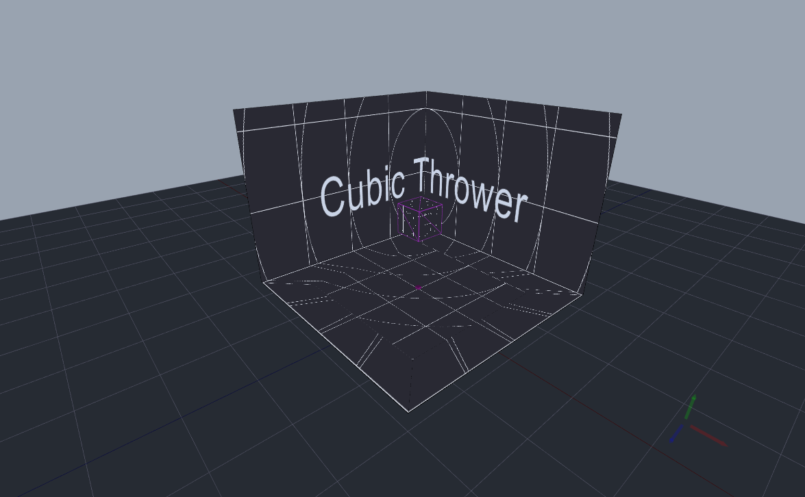

**Good to know:** In LightAct, it is also possible to achieve cubic mapping. This type of mapping can be achieved with the help of a [Cubic Thrower](broken://pages/HvMoHhVRSy65RVsqvKrk).

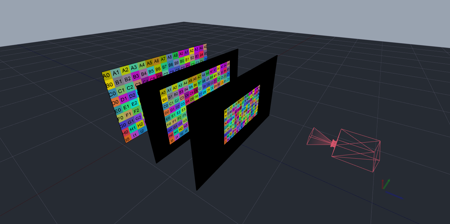

## Parallel mapping
<figure><img src="https://3312042618-files.gitbook.io/~/files/v0/b/gitbook-x-prod.appspot.com/o/spaces%2F9sVaJpWJhPbmscipukhh%2Fuploads%2Fgit-blob-5f5ce99aba0172428c7f7c7638603842c0a2e7e1%2Fimage.png?alt=media" alt=""><figcaption></figcaption></figure>
An equivalent to parallel mapping in Disguise would be Orthogonal thrower in LightAct.
