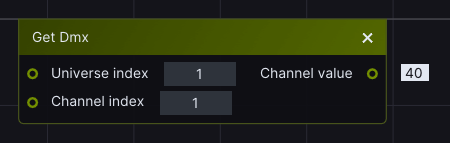

Once you have enabled DMX In, there is the possibility to get a single channel value via layer node. For this purpose, we've added the *Get Dmx* layer node.
In our example, we are receiving the *Channel value* 40 from Channel 1 in Universe 1.

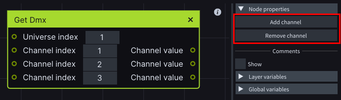

It is also possible to get multiple channel values at the same time from a single *Get Data* node. You can do this by clicking on the **Add channel** button in the *Node properties* of a selected *Get Data* node.
<div align="left"><figure><img src="https://3312042618-files.gitbook.io/~/files/v0/b/gitbook-x-prod.appspot.com/o/spaces%2F9sVaJpWJhPbmscipukhh%2Fuploads%2Fgit-blob-7446fb382287839ad46a72a63fa45b03dadb3dc4%2Fimage.png?alt=media" alt=""><figcaption></figcaption></figure></div>
Similarly, to remove a channel from the node, simply click on the **Remove channel** button.
