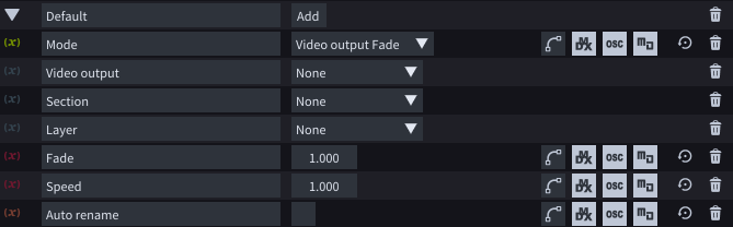

<div align="left"><figure><img src="https://3312042618-files.gitbook.io/~/files/v0/b/gitbook-x-prod.appspot.com/o/spaces%2F9sVaJpWJhPbmscipukhh%2Fuploads%2Fgit-blob-df87929b6b593f7e17dd506f3d101eb229f827c6%2Fimage.png?alt=media&amp;token=f9f27418-e63c-4b2f-bd8b-e323413de31f" alt=""><figcaption></figcaption></figure></div>
* **Mode**: select the fade of what you'd like to adjust. Options are:
  * *Video output Fade*: adjusts the fade of the selected Video output.
  * *Section Fade*: adjusts the fade of the selected section.
  * *Layer Fade*: adjusts the fade of the selected layer.
* **Fade**: set the new value of the fade. 1 = 100% (fully on), 0 = 0% (fully dimmed).
* **Speed**: adjust the speed of the adjustment. 1 means real-time. If you set it to really small values, like 0.2, the fade value will adjust slowly towards the target value.
* **Auto rename:** select if you want the layer's name to display the state of the variables.
