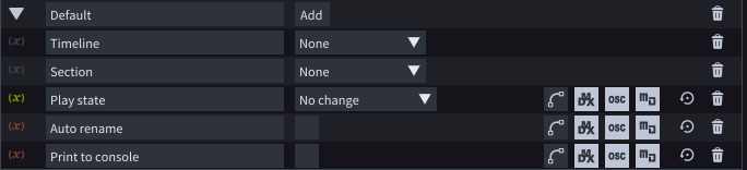

<div align="left"><figure><img src="https://3312042618-files.gitbook.io/~/files/v0/b/gitbook-x-prod.appspot.com/o/spaces%2F9sVaJpWJhPbmscipukhh%2Fuploads%2Fgit-blob-1e355ef076f43d7a60730b5cc30a264e680b28c9%2Fimage.png?alt=media" alt=""><figcaption></figcaption></figure></div>
* **Timeline**: select the timeline where you want to execute the jump
* **Section**: select the marker to which you want to jump to. This value is ignored if Mode is anything other than *Go to selected*.
* **Play state**: select the timeline's play state after the change. The default is *No change*.
* **Auto rename:** select if you want the layer's name to display the state of the variables.
* **Print to console**: if checked the layer is going to print to the *Console* window a message everytime a jump happens.
