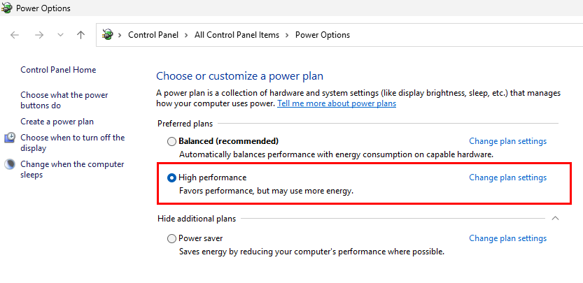

1. It is important that your system configuration is set to **High performance**, **Ultimate performance** (if available) or **LightAct** custom performance (available on some LightAct servers).
