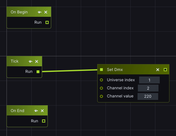

It is also possible to set a value of a single channel with **Set DMX** layer node.
In our case, we overwrite Channel 2 in Universe 1 with the Value 220. This value will be sent, along with other DMX Channel values to the final endpoints, or DMX nodes.
<div align="left"><figure><img src="https://3312042618-files.gitbook.io/~/files/v0/b/gitbook-x-prod.appspot.com/o/spaces%2F9sVaJpWJhPbmscipukhh%2Fuploads%2Fgit-blob-ed7820189fb8d2e1e7a3780717e942e7fbb4783e%2Fimage.png?alt=media" alt=""><figcaption></figcaption></figure></div>

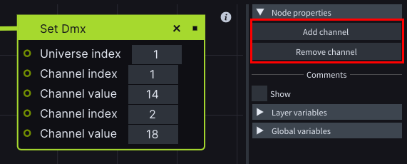

It is also possible to set multiple channel values with a single *Set Data* node. You can do this by clicking on the **Add channel** button in the *Node properties* of the selected *Set Data* node.
<div align="left"><figure><img src="https://3312042618-files.gitbook.io/~/files/v0/b/gitbook-x-prod.appspot.com/o/spaces%2F9sVaJpWJhPbmscipukhh%2Fuploads%2Fgit-blob-4e5d7ead1bc63bdf334227780fc2a1bedfd2d8f3%2FSetData.png?alt=media" alt=""><figcaption></figcaption></figure></div>
Similarly, to remove a channel from the node, click on the **Remove channel** button.
