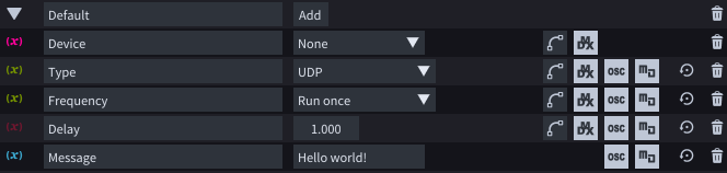

<div align="left"><figure><img src="https://3312042618-files.gitbook.io/~/files/v0/b/gitbook-x-prod.appspot.com/o/spaces%2F9sVaJpWJhPbmscipukhh%2Fuploads%2Fgit-blob-5a19e9b2d418552d23cc4f78a9b7cecc50dbd5c3%2Fimage.png?alt=media" alt=""><figcaption></figcaption></figure></div>
* **Device**: select the device which you want to use as the receiver of the message.
* **Type**: select the type of the device you selected in the Device variable. It determines whether you are sending UDP, TCP or OSC message.
* **Frequency**: determines the frequency with which the message is sent. Options are:
  * *Run onc&#x65;**:*** this means, the message will be sent once every time the play head enters the layer.
  * *Delay*: this means, the message will be sent continuously with a delay as long as the playhead is on the layer.
* **Delay**: if you specified *Delay* in the *Frequency* variable, this is where you determine the duration of the delay.
* **Message:** message you'd like to send.

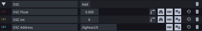

<div align="left"><figure><img src="https://3312042618-files.gitbook.io/~/files/v0/b/gitbook-x-prod.appspot.com/o/spaces%2F9sVaJpWJhPbmscipukhh%2Fuploads%2Fgit-blob-9f0ead05cf172328730faa656b98bcbc2b030358%2Fimage.png?alt=media" alt=""><figcaption></figcaption></figure></div>
These variables are applicable only if you selected one of the OSC options in the *Type* variable.
* **OSC Address:** configure OSC address under which the data is going to be sent.
* **OSC Float:** this is the float value you will be sending if you chose *OSC Float* as the *Type* of the message
* **OSC Int:** this is the float value you will be sending if you chose *OSC Int*as the *Type* of the message
* **OSC String:** this is the float value you will be sending if you chose *OSC String* as the *Type* of the message
