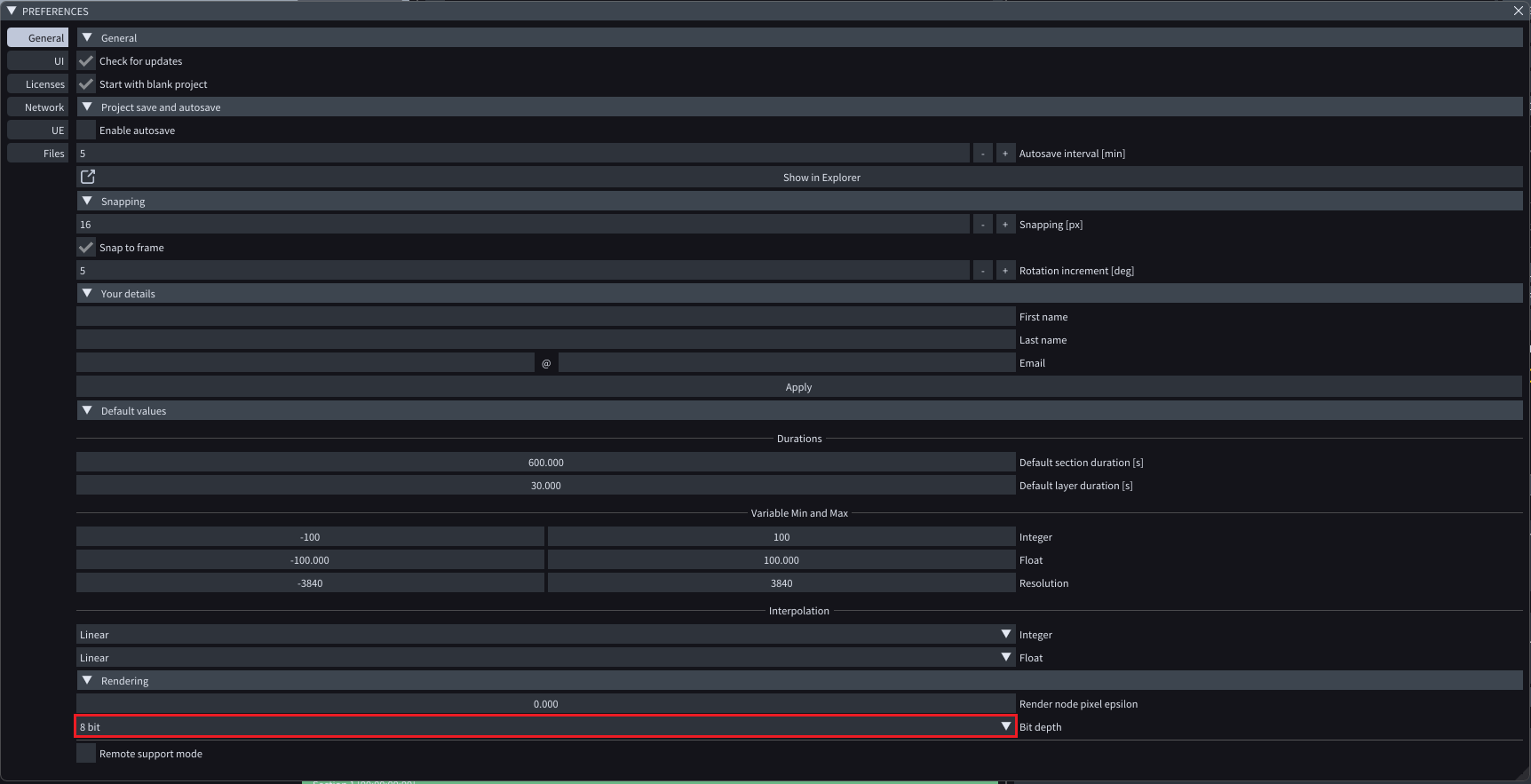

## **Enabling 10-bit in LightAct**
In LightAct, click on **Edit** tab and then **Preferences.**
<div align="left"><figure><img src="https://3312042618-files.gitbook.io/~/files/v0/b/gitbook-x-prod.appspot.com/o/spaces%2F9sVaJpWJhPbmscipukhh%2Fuploads%2Fgit-blob-7e65f85be2038c171ed5ae67e0ce2517f70aa3ff%2FUntitled2.png?alt=media" alt=""><figcaption></figcaption></figure></div>
Under **General** tab select the **10-bit** option from a drop-down menu. Restart LightAct to apply the setting.
