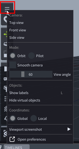

Most Viewport settings are accessible in the Properties menu of the Viewport.

There are 3 predefined camera positions: Top, Front and Side.

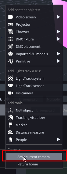

If you right click anywhere in the Viewport you can also create a custom camera position.
<figure><img src="https://3312042618-files.gitbook.io/~/files/v0/b/gitbook-x-prod.appspot.com/o/spaces%2F9sVaJpWJhPbmscipukhh%2Fuploads%2Fgit-blob-0f2350db19ab516d291a24f2008e8f44bc755d17%2Fimage.png?alt=media" alt=""><figcaption></figcaption></figure>
You can then recall it in the Viewport properties menu.
