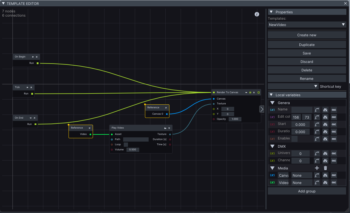

A Template Editor will automatically open up and present you with your saved template. You can also open it yourself either from the Window or by pressing F8.
It looks very similar to a standard Layer Layout, but with some additional buttons on the right.

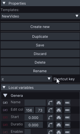

You can assign your new template a shortcut key by choosing it from the menu and clicking save.

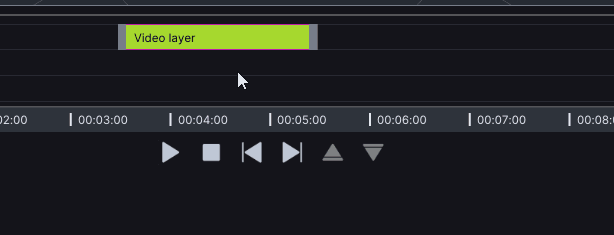

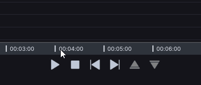

Now hold down a selected number and left click on the timeline to create a new layer based on the template you created.
