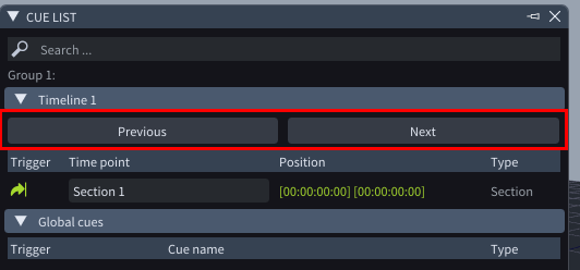

LA4-7229: Jumping To Previous Landmark/cues If Playmode == Playing
Fixed an issue where in Play mode, the previous-cue buttons only returned to the start of the current section and never to the actual previous cue, even with rapid presses. Restored the intended logic: if playback is within n seconds after a cue, jump two cues back; otherwise, jump to the nearest cue before the current time.
Status: Done

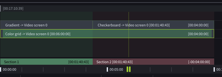

LA4-7228: Crossfade If One Of The Layers Exists Across Both Sections
Fixed an issue where, during crossfades (Dip/Hold) between sections, the exception layer rendered on top, leaving Color Grid above until Gradient/Checkerboard appeared abruptly. Crossfades now preserve background continuity: non-exception layers transition normally, while the exception layer is rendered to a texture on the source side and reused at the correct moment on the destination. Included in 4.16.1.
Status: Done | Requesters: MPR
