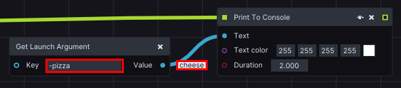

### Custom launch arguments
In LightAct, you can also create your own custom launch arguments which you can then read through the *Get Launch Argument* node. The string after the dash is considered the key, and the string in the quotation marks is considered the value.
For example, if you launch LightAct with the formatting *"C:\Program Files\Lightact\Lightact4\Lightact4.exe" -pizza "cheese", -pizza* is your *key* and *cheese* is your *value*.
