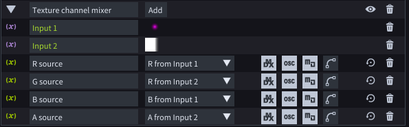

### **Texture channel mixer**
<div align="left"><figure><img src="https://3312042618-files.gitbook.io/~/files/v0/b/gitbook-x-prod.appspot.com/o/spaces%2F9sVaJpWJhPbmscipukhh%2Fuploads%2FkMEHQkpo5GuAVjgjE6uP%2Fimage.png?alt=media&amp;token=5010ff03-5d80-4517-9f6f-4617b95c44af" alt=""><figcaption></figcaption></figure></div>
* **Input 1**: the first of the two input textures. It needs to come from another layer using [Layer connections](/layers-and-layouts/layer-connections.md).
* **Input 2**: the second of the two input textures. It needs to come from another layer using [Layer connections](/layers-and-layouts/layer-connections.md).
* **R source**: using the dropdown specify which channel of the 2 input textures will be used for the R channel of the output texture.
* **G source**: using the dropdown specify which channel of the 2 input textures will be used for the G channel of the output texture.
* **B source**: using the dropdown specify which channel of the 2 input textures will be used for the B channel of the output texture.
* **A source**: using the dropdown specify which channel of the 2 input textures will be used for the A channel of the output texture.
**Good to know:** if you are using a black & white texture without alpha as the alpha matte (where white means completely transparent and black completely opaque), then you need to set the A source as either R, G or B (but not A) of that texture.
