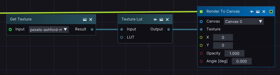

Give the *Texture Lut* node a *Texture input* and connect it to an active *lifeline*.
<figure><img src="https://3312042618-files.gitbook.io/~/files/v0/b/gitbook-x-prod.appspot.com/o/spaces%2F9sVaJpWJhPbmscipukhh%2Fuploads%2Fgit-blob-2bb463e2626822e95d0fbb69d9b72b572b70601f%2Fimage.png?alt=media" alt=""><figcaption></figcaption></figure>

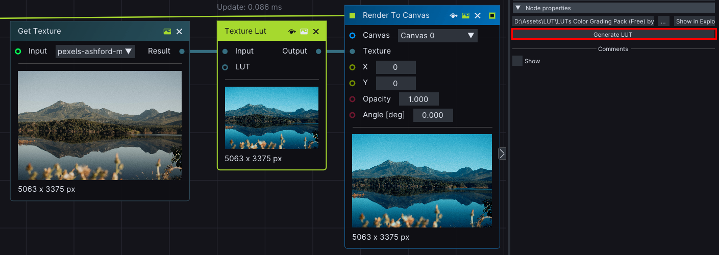

To use apply a pre-existing LUT to the chosen *Texture input*, select the *Texture Lut* node and navigate to its **Node properties**, on the right-hand side of the *Layer Layouts* window. Under the **Node properties** collapsible, click on Browse button and locate the LUT file in *File Explorer*.
<div align="left"><figure><img src="https://3312042618-files.gitbook.io/~/files/v0/b/gitbook-x-prod.appspot.com/o/spaces%2F9sVaJpWJhPbmscipukhh%2Fuploads%2FyvnArII9gdceyALnoAxc%2FtextureLUT.png?alt=media&amp;token=83161464-3518-44ff-832d-e0cf5558f71d" alt=""><figcaption></figcaption></figure></div>
Finally, click **Generate LUT** button to see the results.
<figure><img src="https://3312042618-files.gitbook.io/~/files/v0/b/gitbook-x-prod.appspot.com/o/spaces%2F9sVaJpWJhPbmscipukhh%2Fuploads%2Fgit-blob-3d43f305db6c13c66ddb3745f4340258d481da32%2FGenerateLUT.png?alt=media" alt=""><figcaption></figcaption></figure>
**Good to know:** LightAct supports *\*.3dl* and *\*.cube* file types, as well as a *Texture* as a LUT input.
