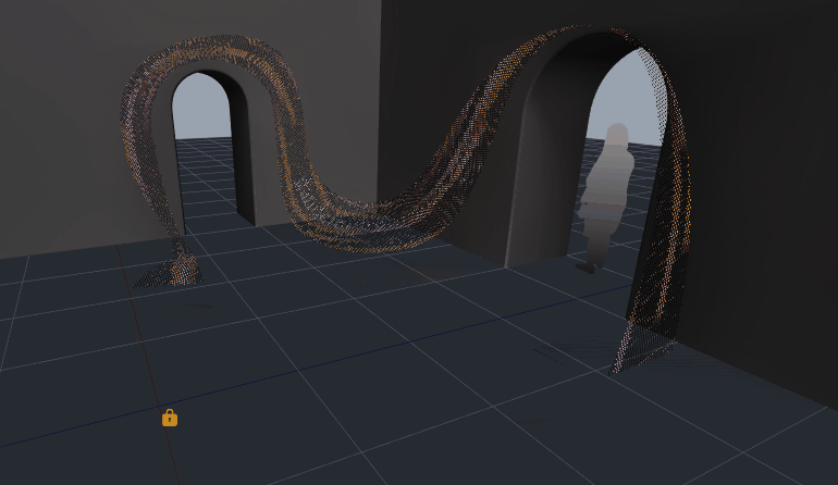

2. If you want to visualize it in the Viewport, you may want to import the 3D model of the DMX setup and render the content onto it.

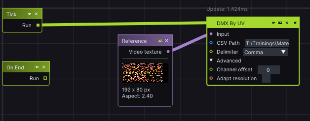

### Using DMX by UV node
<div align="left"><figure><img src="https://3312042618-files.gitbook.io/~/files/v0/b/gitbook-x-prod.appspot.com/o/spaces%2F9sVaJpWJhPbmscipukhh%2Fuploads%2F4CzIk6c7ssGigYR7bfUd%2Fimage.png?alt=media&amp;token=9294221a-c618-4bab-9b97-c39a44ce3882" alt=""><figcaption></figcaption></figure></div>
The inputs in the node are:
1. **Input**: texture that you want to use as the source of RGB values.
2. **CSV path:** path to the CSV file. You can use the **Browse** button in the *Node properties* on the right.
3. **Delimiter**: which delimiter is used in the CSV file
4. **Channel offset**: determines if you want to offset the channels in the CSV file
5. **Adapt resolution**: if this is checked and if the incoming texture has a different resolution than the CSV resolution, LightAct will use relative pixel coordinates.
In the *Node properties* dropdown menu, you can select a different **Pixel type** or even determine a custom one. It determines how many consecutive channels one pixel takes up.
